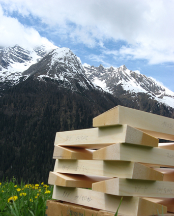

[QUOTE=fmorelli]Swiss Spruce from Switzerland. I ordered 30 kilograms (about 60 lbs) which is the maximum they can ship. It is north of 40 grains per inch. Super stiff.
   hey what was the cost in american rubles for the 60 lb plus shipping ?   thanks jody
Filippo[/QUOTE]
